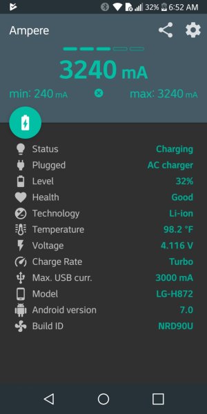

For example my G6 charges at the same speeds when I hook up my Macbook Pro USB C charger to it according to Ampere as it does through the Wall chargers I have for both QC 3.0 and QC 2.0.
Plugged into my Macbook Pro Charger:
