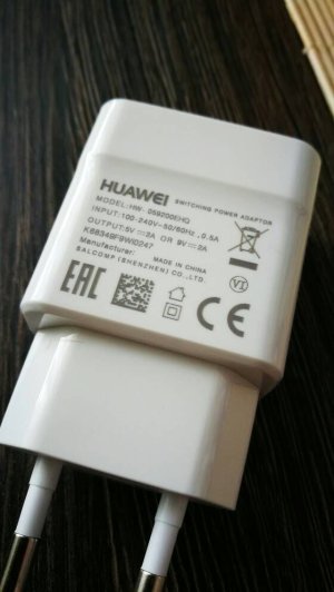

Only Huawei branded chargers will work. Just received this one. Works perfectly.
Original 9V 2A EU US Adaptive Fast Wall Charger for Huawei P9 Plus HTC Oneplus | eBay
And it works in very interesting way. Yet I think it really saves a battery. I have a power meter in my 220V power outlet. At first charger kicks at 16W power mode. Later another mode I've noticed was some kind of trickle charging, when power meter showed the charger changing it's power used: 16W - 11.5W - 16W - 11.5W. Just more later - steady 11.5W. And it has to do a lot not with how much battery left, but with it's temperature. If your phone just feels warm in your hand - the charger won't kick to 16W mode even at the beginning.
The final result here: started charging at 34%. 30 minutes later I had 74%. With 3000mAh battery inside 40 percent in 30 minutes seems to be quite impressive to me.
PS. Phone also indicated charger properly, so you will see on-screen message it is not "Charging", but "Fast Charging".
