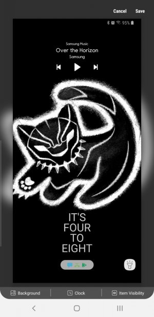

I use LockStar (part of the Good Lock 2018 apps). In there, you can set one of the on-screen application to be the flashlight. I wish I could set the flashlight as one of the apps for the bixby button, but hitting the power button and hitting the flashlight icon on screen is good enough for my needs.Screenshot_20190318-111621_LockStar.jpg
