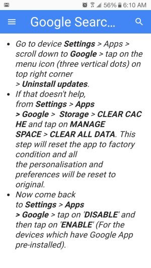

Hopefully the screenshot attached above shows the step. I used the first suggestion. Had to uninstall the Google update. Afterward I went back into Google settings and setup the associated email account, retrained the OK Google voice and set up the Assistant. Then I tried setting an alarm. THIS time, the assistant opened a screen with the option of using the Clock or DigiCal for alarms. FINALLY, it is working normally and random alarm shows up in the Clock/Alarm section. Hooray!
