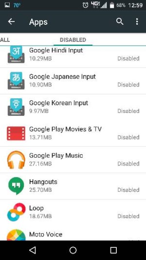

I'm wondering if it could be an app I have disabled...

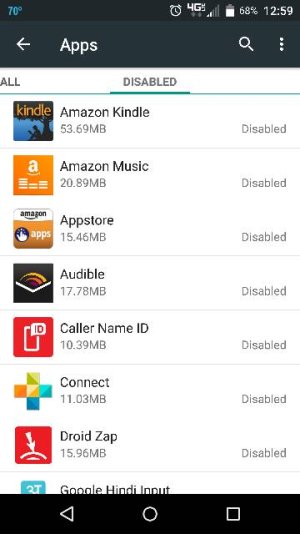

Some reason I can only post 1 pic at a time.

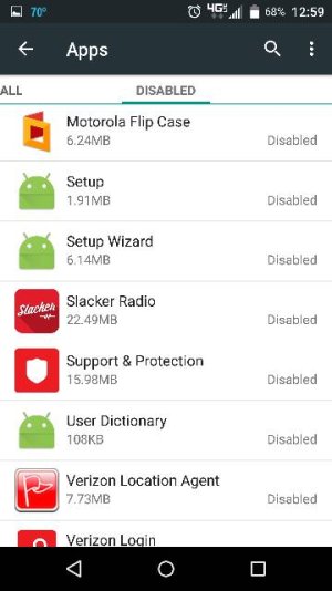

Sorry... Train wreck on the double pics

I'd reenable vzwapn and vzw_api for sure. I don't know if it's that, but those seem like critical services.

As I said earlier this would happen mostly when I was taking my phone out of the holster. The holster has 2 pretty strong magnets and I got to wondering if that was having an effect. I took the holster off and held it against the back of my phone and moved it around. Sure enough I got some pretty weird responses. The screen lit up and gave me some unusual home/lock screen views. I never got it to reboot doing this but I went into apps and disabled the Motorola Flip Case app. After doing that The magnet still gave me some of the same weird screen views but of course not the half screen for the flip case. Since doing this about 4 days ago I haven't had a reboot. I'm hoping that solved my issue. I could of course reinstall the app to see if I could get the reboot back but right now I'm just satisfied that it is gone (at least for now).
