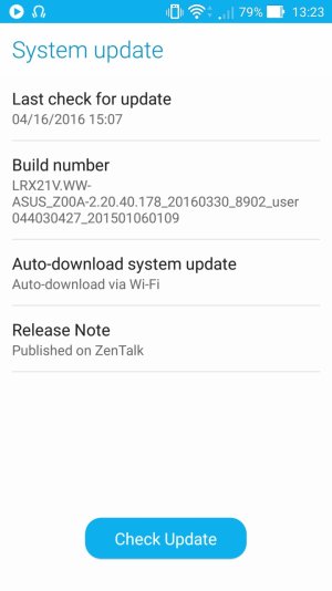

Is this my firmware? I also just got this update, hope the error doesn't happen now.
Difficult to say. The recent trauma does raise the question of a hardware problem. See what happens with the new update.
