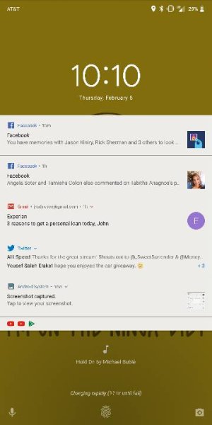

I'm having same issue , says rapid charging then next to it 4 hours to charge and it's at 45% right now ...tried different chargers which was also fast chargers same thing
Mines even worse says rapid charging and going to take 11 hrs
