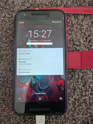

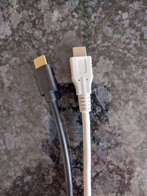

Well, here are the pics:
On one there is a phone being charged rapidly, on the other it's a comparison of the fast (white) cable with some other I have bought somewhere else. (the photo is taken from the usb-c side, presumably).
