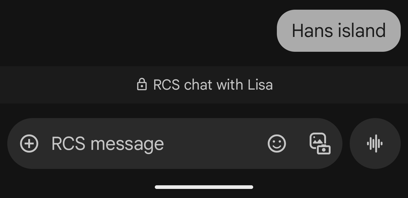

Another thing am I supposed to get an SMS from google after pressing that button. I never got one.
Nope. You will see something like this though when texting with others that have RCS enabled .
