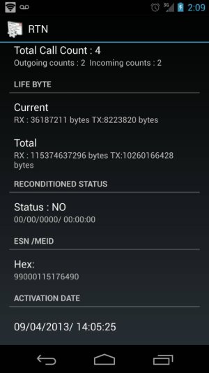

Approaching 90 hours without a reboot! Two things I noticed though... 1. When I went to install a ROM the bootloader was already unlocked. 2. I think it's a NEW phone, not a refurb like they normally do for TEP replacements.
