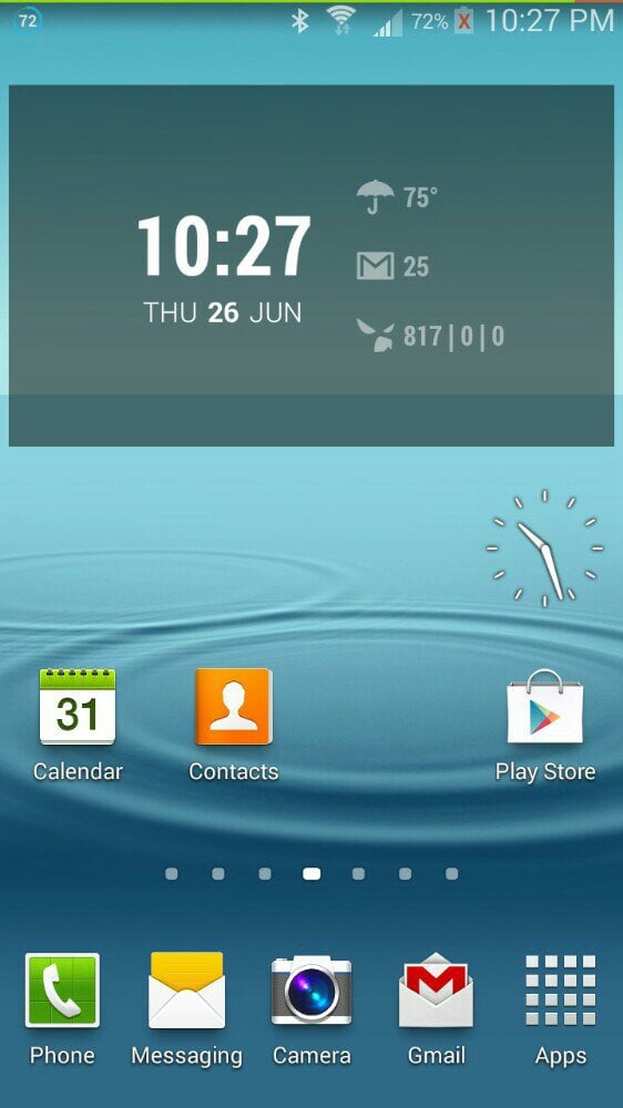

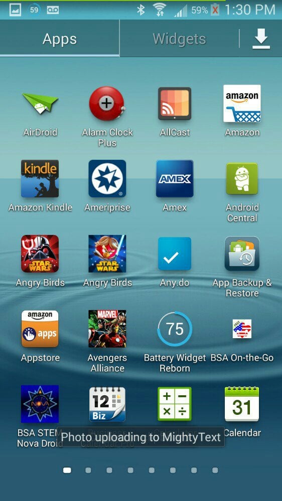

Every time I put my 4.4.2 KitKat updated GS3 the battery icon had a red x on it. I have tried 4 different cables, chargers, car chargers, different amps from .5, 1, 1.3, and 2. I have even tried using 3 different external battery chargers. My big issue is not the x but it charges like molasses. I used to be able to plug the phone in my car charger and run Maps. Now I loose battery instead of gaining charge of staying the same. This leads to the second issue that Maps and Location / GPS are draining the he** out of the battery. I did a factory reset to see if it would help with this and the drag.. I have half the apps than before and very slow.
The bottom pic is before factory reset and the top is after factory reset.

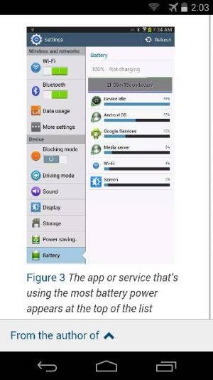

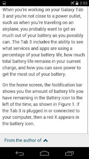

OK I think this should help everyone out with this supposed problem, when its not a problem!! So search what I searched and go to the video and watch the whole video, then go to the battery pics and read what it says, but notice that even when the tablet is charging in the pic it still shows a "red x" is just like the guy said it is the amp at which the tablet or phone is charging is to low so, it is still charging but at a lower and slower rate. And if you are using the charger that came with the tablet OR (S3 this applies to it too) then clean the charging port and charger, if it still shows the x try a different charger for that device that came from another Samsung s3 or tab of the same model!!!!! Hope this helps!!:) p.s. you probably can't see the "x" in the pictures but its there in every picture.

After more testing and researching this and other forums.. The red x represents low charging. Some phones show this as a notification and apparently instead of words this update shows the x. This means the phone is charging just not at an decent amp. I assume the SG3 is requiring more than .5 mAh. When I try charging with 1.0 mAh or 2.1 mAh there is no x and the phone charges normal or faster (on 2.1). This all includes external batteries..
I was assuming you were using the original charger! Yeah, half an Amp is not even enough to power your phone with screen on and an app using GPS active.
