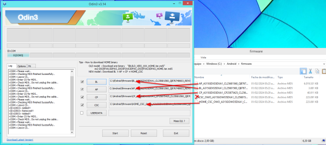

So, this is what I've selected based on what I understood from your post, but please correct me if there's something wrong :
From there, I would connect the phone in "download mode" and then hit start.

Ok, so I think I'm ready but I'd like to double check some details.

Yeah you got it correct in your screenshot
Home CSC to save Data and the regular CSC firmware will factory reset

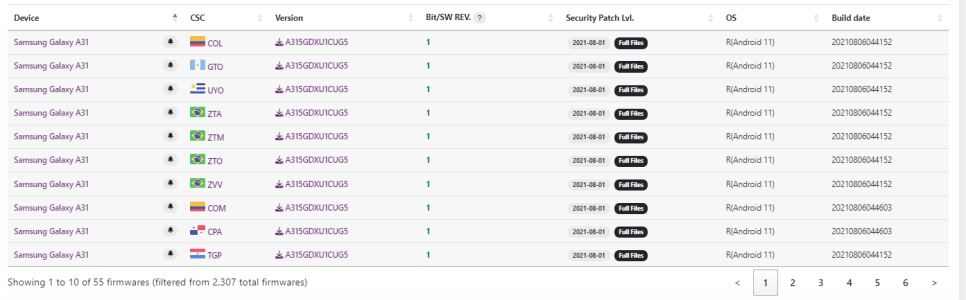

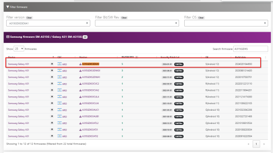

well, just a final idea before I give up: I was wondering about trying to downgrade the OS... could that have any chance?
But then it seems there is no good candidate for this phone: for what I just read, since it has "bit 5" (?) (baseline is"315GDXS5DXA1") it would require a "binary 5" image and there are not such image of android 11 or 10 according to my search:
Code:
https://samfw.com/firmware/SM-A315G/ARO
What about using an non-adecuate image?
Rendering the phone unable to use a carrier would be no problem in this case because I only care about the phone's contents.
What is the worst effect that could have?
Should I still care about "binary number" (bit) ?

oh, dang!..
Code:
Unfortunately can't go back once it has updated, Samsung doesn't allow you.
