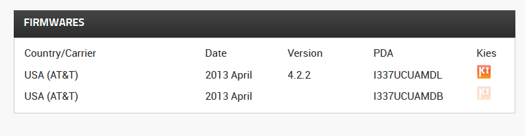

Let me see if I can find one for you :)
Edit: Ok, so I couldn't find it on SamMobile probably since the 4.3 update just released. You could probably flash the 4.2.2 firmware and then update to 4.3, that should unroot it :)
Downgrade did not work.
I guess now I will have to wait till I come across a MJ9 Firmware release.
