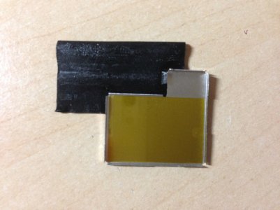

See this metal shield/cover below?

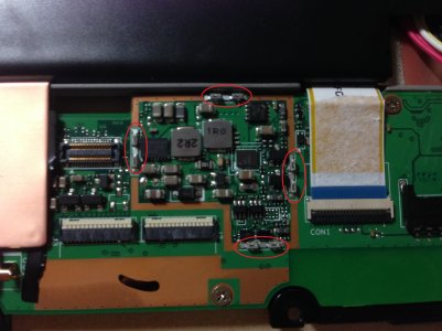

Now look at the main board section below where this metal cover is supposed to go.
You see those eight shiny components that I've marked with the red circles. I didn't pay any attention to the placement of the cover when I was first putting it back together. I just lay the cover in that area and secure it position with the tape. However, given a little bit more thought, I think the metal cover is not supposed to have direct contact to the main board, especially when there is something that looks like exposed ground traces in the proximity. I took a better look at those eight shiny components and it turns out they are stands (with a slit in the middle) which I guess is suppose to hold the metal cover in place but lifted above the main board. I make that change and (voila!) now everything is back to normal. That nice unlock click from the speak have never sounded so nice.

Excelent! It solved the audio problem. Thanks adams tong! :cool:

I had to join here just to thank you Adam, this has completely solved my sound problem too. Again this happened after replacing the cracked screen. The sound would only play using earphones. Non of the you tube videos mention about replacing the cover carefully. You've made my day now i've got it fixed for my grandson
