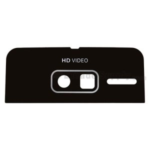

Can anyone tell me how to remove and replace the Motorola Droid Razr M Battery Door Glass Lens

Hey did you ever get this fixed? I need to replace mine too.
I do have some advice though: I broken mine by trying to pry it out from the little insert at the top toward the middle. I put a razor blade there and pulled up gently, it snapped and shattered :/ However from disassembling the rest of the device, there is adhesive all around the phone. so I would try heating it up then prying VERY gently.
Otherwise please share where you are at with this, thanks!

Anyone have a DIY instruction on this? I just ordered the glass. Is it as simple as heating the glass up with heat gun and prying the glass off with a razor blade. Put new glass adhesive down and put the new glass back on?

I just removed my, I cracked it. You need to heat it to remove it. It has sticky tape on the back of the glass. I am now waiting for the replacement glass to arrive. Hope that helps.
