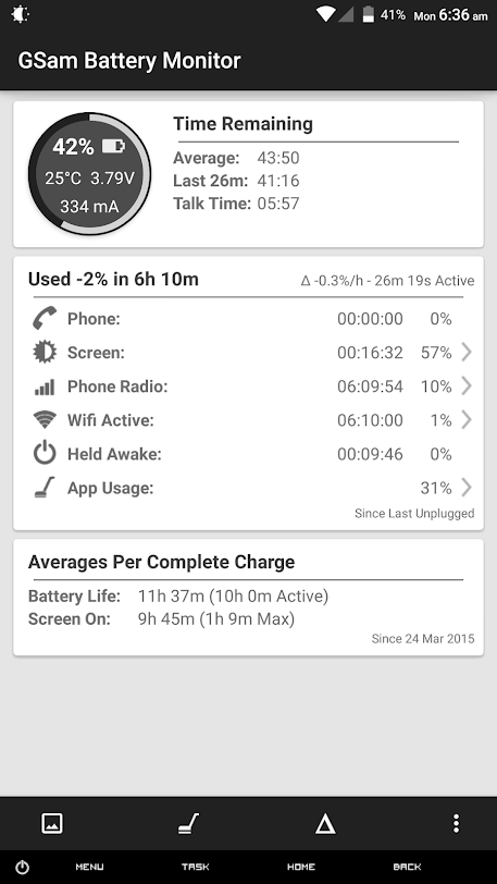

Since this battery is exactly twice the capacity of the stock battery, it is very easy to compare numbers and statistics. So let me share with you some figures. During these tests, I would use my phone regularly with texting, browsing the web, watching YouTube videos, reading comics, playing some games. Nothing too extensive, as I tried to keep an average on-off usage throughout the day without long sessions of games or videos as to keep numbers similar.
Please note: These screenshots have average times listed at the bottom of them for Battery Life and Screen On. Ignore these numbers as they are not only inaccurate, but erroneous. I think it's an issue with GSAM, which is the application I use to gather numbers.
*Stock 3,000mAh Battery* Reference point of half battery at 3:00 hours SOT (moderate brightness, mix between 30%-50% using Lux brightness app). This really shows what I am capable of getting on the current ROM with tweaks on a STOCK battery of 3,000mAh. This also includes the 100% overcharge, which will give you added SOT if you start at 100%, since these batteries are so large, they charge over what capacity they think they're capped at.
Half battery with the 6,000mAh MPJ at 6:24 hours SOT (moderate brightness settings, same as the screen before with stock). Impressive amount of time spent with the screen on. This is including an overcharge at 100%, which I'm sure you've seen on your stock battery. It's just more pronounced on this because it's double the capacity. Estimated around 7 minutes and 35 seconds per %. Since there is overcharge at 100% involved, the numbers will be slightly skewed so please see the estimates for the next screenshot.
Usage without the 100% overcharge, which throws numbers off. I started recording SOT at 97%. (this estimates to 7 minutes per % or 11h 45min total SOT) Very impressive and matches what LG is putting in the G3.
And example of some strange battery readings that have popped up after rebooting and having the battery sit for a while. I've noticed this once a couple times in the week of testing this. I'm not sure what it means, but the below screenshot was taken after my phone was sitting next to my bed overnight. Normally I get 1-1.5% loss overnight, but with the large battery it's more like .5-1%
