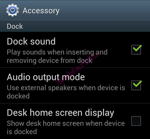

The cable is supposed to tell the phone it's docked, and launch car mode apps if you configure them properly. And, if you check the Audio Output Mode option
it is supposed to direct sound to the 3.5mm cable output instead of the headphone jack. This might be a solution for those who can't seem to get the headphone jack and Bluetooth to work at the same time.
So this morning I gave it a try on my way to work. It does, indeed, tell the phone it's docked. In fact, even if the USB end isn't plugged into a charger, just plugging the micro-USB plug into the phone triggers car mode. And it does route audio out the USB port. So far, so good.
