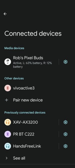

This started happening about a week ago and it's really annoying. I can't seem to get through one session at the gym before the right one drains enough to shut down. Any idea about a cause or solution? No other issues with these at all since I got them in 2020.

On the Google support forums it was suggested that I take the left bud out of the case for use first (out of habit I always take the right out first). When I did that the behavior changed and instead of the right bud draining quickly now it's the left doing it.
Something wonky is going on, because I just noticed similar behavior with my Pixel Buds 2nd gen, except it's my left bud that's draining quickly (while the right bud is remaining at 100%). I also reset my buds, and it didn't help.

I'm still seeing the same behavior. I posted on the Google support forums and basically got no real information. I notice a difference in charge between left and right of about 25% after 90 minutes of use and the bud removed from the case first is always the one that drains the fastest.
