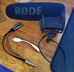

Hey guys.
I have a Note 10+ 5G and I'm trying to get a Rode VideoMic Pro to work with it.
I bought the official Samsung USB-C to 3.5mm dongle. When using this alone, the phone doesn't even pick up the mic. It just records audio from the phone mic.
Then I bought a headphone/mic splitter, because the Rode VideoMic Pro doesn't have the typical four rings for a mic plug; only three (as you can see in the picture), so I don't think the Note 10+ recognized it. When I record with the dongle and the splitter, I get an annoying clicking noise every second or two and can barely hear my own audio, an issue that some others seem to have experienced.
In an attempt to troubleshoot, I tried the setup on my iPad Pro. With just the dongle, the iPad didn't see the Rode VideoMic Pro. With the dongle AND the splitter, the Rode worked perfectly, so I know all the individual components are working.
Is there a known issue with the Note? Is there a dongle that would actually work better than the official Samsung dongle? I'm just at kind of a loss, because I would love to use this phone to record video, but not really without an external mic, and it should be able to handle one.
Thanks in advance for any help!
Have you looked at usb setting in developer options, maybe it's set to charging only
