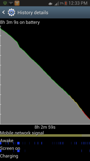

I had a major battery plummet while asleep, I got 8 hours of battery time and there was only like 20 mins of screen time. Two things have changed. I got an Otterbox Commander Series case and I changed the security to PIN instead of just Swype. I've turned the security off and am going to see how my battery does. My signal has still been fine with the case, but if changing the security doesn't help, then I'll remove the Otterbox and see if that helps. If that doesn't, then will see about AT&T changing my battery out first.

But look at the "awake" bars vs the "screen on" bars. screen was off almost the entire time but the "awake" time was off and on all night.

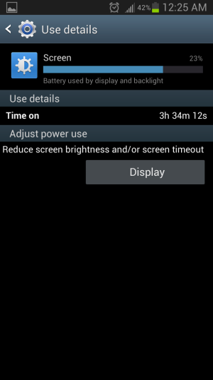

Hmmm..took my case off for a little bit and look at the color on my signal bar now...

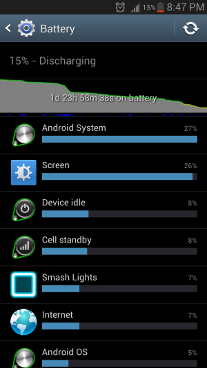

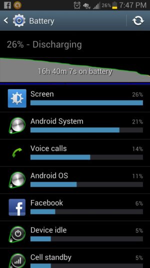

This is long but it's my history for the past 3 weeks. I am not tech savvy. Everything IMO. soo.. YMMV. I tried to get the same results where I got nearly 4 days of battery usage (probably 2.5-3 days under normal use). Initially heard someone get 2% during 8 hours overnight and tried to match but ended up losing my best charge messing with charging methods.
Current Phone Provider: SPH-L710 Sprint. Unrooted stock OTA JB 4.1.1 My data speeds are 1mbps for 98% of my area. Sad, I know. Had my phone for 3 weeks. We don't have 4G here.
Battery Draining Trend:
Currently inconsistent. ~2 days under normal usage YMMV. Approximately 1% discharge per 2 hours when not in use. The best (once) I've gone is 1% every 2.5 hours on standby. During on-screen use, I drain 1% every ~4 minutes and much more if I am downloading. This is during ICS and JB (now).
Battery Charging Method
Stock Samsung USB wire with LG Optimus wall adapter (Output 5.1V--0.7A)--I like slower chargers (Stock wall 5.0V--1.0A). Currently charging at 10% to 100% phone (powered off) for 3.5 hours. Pulled plug out. Wait for 15 minutes and reinsert until 100% shows up (~15-30mins). Pull plug and (optional - IMO ease battery strain) wait 10 minutes before turning it on. Will test out charging from 20-30% to 100% in upcoming charges. I pay close attention to how long it takes to go from 100% to 99%, 1% per X idle minutes, 1% per X on-screen minutes, how long did it take to charge and usually continue to charge the average time it takes. I associate short charging time (with the same charger) = bad battery/calibration. If it's been the same then, then a fast discharge must be from the the phone itself/app/corrupt file etc.
Personal Daily Activity
Mostly gaming and surfing the web. Data is always off. Wifi only when in use. 5-8 incoming text, 0-3 outgoing text; 15min-1hour online surfing/forum, 30min-1hour gaming, 3-4 2min calls; No social apps, No productivity app, No widgets, 1 battery stat app (ave voltage 3900mV, Temp 20C), 2 home screens
JB installation
I went from ICS to JB but did a full hard reset before and twice after installing JB. (Really tempted to do another hard reset) JB intially had bad discharge at 1% per hour with standby even though I charged to full when at 30% and then at 5%. To solve, I did a full discharge to 0% and recharge for 5.5 hours (taking out the plug and reinserting it at 2hr and 4hr because someone was hogging the charger so I dunno if it was fully charged or not). This gave the best battery charge (see screenshot nearly 4 days, wished I checked on-screen time too). One full discharge and charge, that's all it takes. Afterwards, more full discharges doesn't improve but might have worsen. Currently a charge last me 2 days. I believe I pulled the battery out for 10 minutes at one charging (can't remember if it helped but doesn't hurt to try ).
Screenshots Times

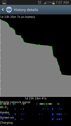

The oldest one shows nearly 4 days but the first 2 days of the 4 had barely any usage just to see how the battery drain. The last two days had fair amount of downloading gaming apps. I had used a 5.0V--0.55V Motorola charger.
My own question why does it takes 3.5hours to charge s3's 2100mah battery when it took 3.5hours to charge my Touch Pro 2's 1500mah battery???

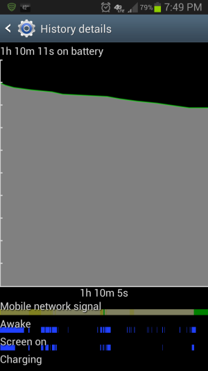

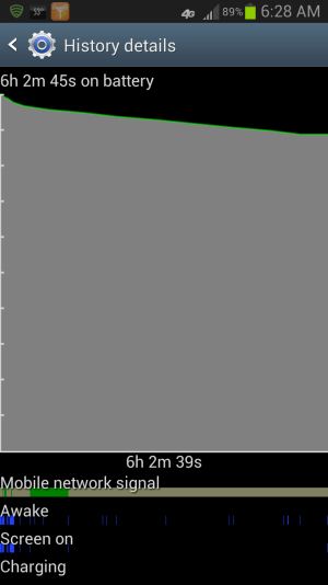

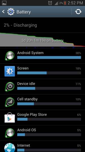

Seems to be an issue with LTE. I turned off LTE before the charging finished and now this is my battery for the last 6 hours.
