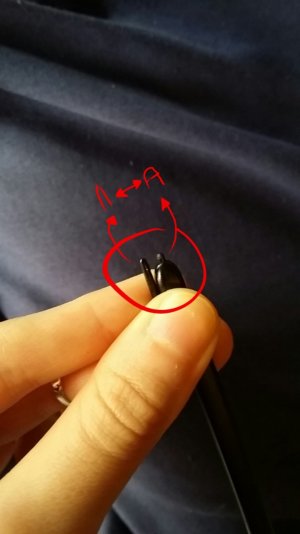

I was having a hard time with this also. I've had my note III for over a year now, and was wondering how to know when to replace the nib for the stylus. The one that came in my s-pen still seems to be working just fine, and I've taken oodles of notes and drawn a lot with it. I was looking at the replacement pack of nibs and removal tool that came with my phone, and I noticed that the new nibs and my old nib look different! the replacement nibs seem like they are hard plastic all the way up to the tip, and are pointier that mine. They don't have the rubbery feeling tip like the old one. Is this because mine is worn out? Or am I not crazy and they are actually different kinds of nibs?

Once I learned they were replaceable and I had extras in the box, I replaced mine quite a few times - it makes a HUG difference. The one that is dark colored with a white tip is designed to provide a certain amount of resistance aka "drag" to feel more like actual writing - and it does wear out eventually. Clean your screen /protector (i have used a ZAGG , professionally installed since the day I bought the tablet, and it makes a huge difference IMHO) and then change the nib and you'll find writing a new joy.
The white one is designed to be smooth rubber on rubber or polymer on polymer, very very smooth writing and no resistance. It is my understanding these do not actually "wear out" or at least, much much less than the other.
