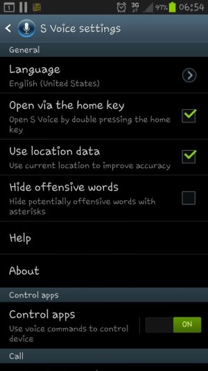

What settings are checked on in s voice? Do you have control apps turned on?

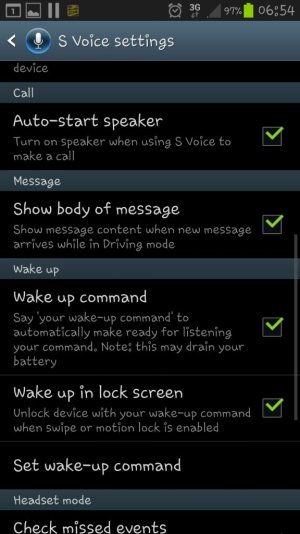

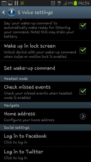

Here are my settings
My settings are identical to AnnDroid, with one exception. I do have the 'hide offensive words' option checked ;)
