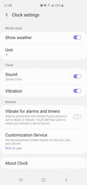

I started to have this same issue after my phone had to be reset which also updated everything to the latest versions. I scoured the internet in many places looking for a solution yet found none. Whilst playing around changing any and every setting I could find I did find the answer to the problem.
Go into your alarm portion of the clock app>
Click the 3 dot info button> Settings
Under the "General" section you will find the "Vibrate for Alarms and Timers" switch that to off. Your alarms should then start playing their designated sound while in the Mute or Vibrate sound mode.
