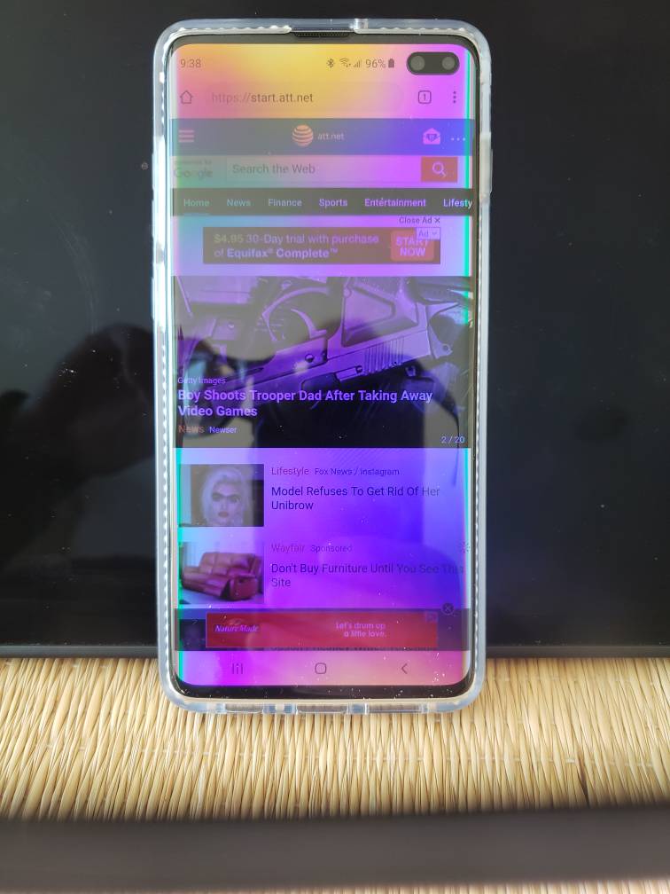

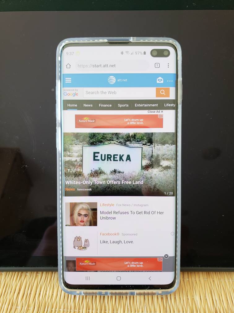

I took two pictures of the S10+ screen (screen protector still installed) with my S9+. One with the camera shooting through my Ray-Ban sunglasses with polarized lens and one without the sunglasses. This is a relatively good representation of what I'm seeing while wearing the sunglasses - except the screen is much darker when I'm wearing them.
