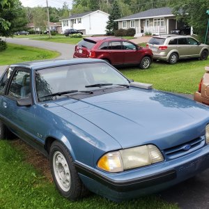

I am working on mine now to get it back on the road just needs paint and some body work. I have owned it for 20 years.
Well my phone is working on the pioneer in my mustang. I wonder if the sync is too old for the new update. It is a 2014 Edge.

Nice , I really missed mine:(
