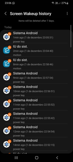

Try Catch show me that one event (12 UI motion) is probably the reason.

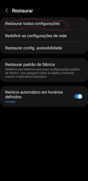

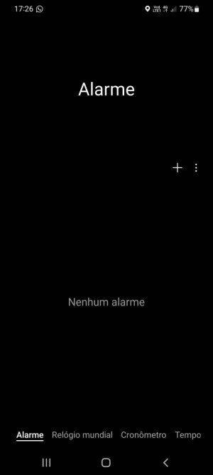

I restored the default configurations but didnt work.
