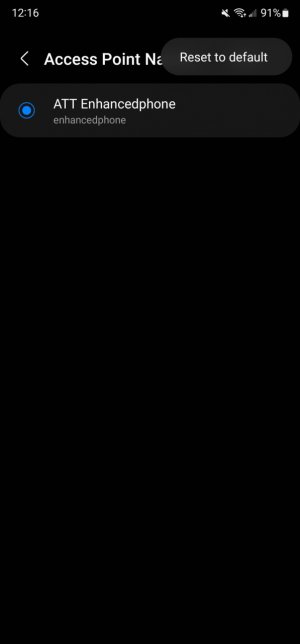

In the upper right corner on APN page should be 3 dots tap it and choose reset to default Screenshot_20220702-121638_Settings.jpg

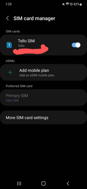

If you can show screenshot of your APN page like my screenshot and go to settings>connection>sim card manager and show us there but block your phone number
My phone is a single SIM phone and I reinstalled it again to be safe. Here are the screenshots.

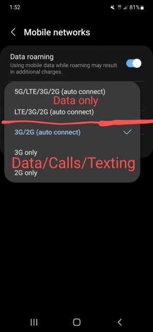

Both LTE and 5G only allow me to use data. For calls/texting I have to set my Network Mode to 3G or 2G.

I know you say that it works on your previous phone but that used lte/3g/2g where as the newer one uses all them including 5g
They are online only. However, I will place the SIM in another 5G phone tomorrow. If it works fine, I'll compare the APN settings. Considering that LTE doesn't work on the S22, but does on my Note 8 and Note 5, then the update could've just bugged the APN settings. If that is the case, I can always try a factory reset.
Yeah, no issues with LTE when I drop the SIM elsewhere. LTE is bugged on the S22 and fine on Note 8/5. The fact it was an issue right after booting back up from an update points to a software problem on the S22 itself.
