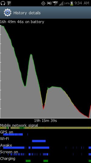

Hmm yeah I'm using the stock charger...I did notice the phone was pretty hot before going to sleep as well. The one thing I see consuming a bit of battery is something called Samsungmaps though I was using my gps quite a bit yesterday of that's in name of Google maps. Here's a screenshot.

another strange thing I just noticed it's that it says it was connected to wifi for a period of time, even though I don't have WiFi. Weird.

Okay next time try this. Make sure your WiFi is off, turn off your GPS and if possible make sure to close out of and stop Samsung Maps from running. I would recommend that you clear your RAM just to be on the safe side. If your phone was very hot that means something was still running that was pulling a lot of power. Download an app as well called CPUSpy. This will give you a breakdown of what CPU states your phone is running over a period of time. Overnight the majority of your time should be in Deep Sleep. If its not, then there is a problem with one of you apps constantly running and not letting your phone sleep.
Go to settings - battery. There you will see a breakdown of what is taking up juice. If the screen is >70%, change the timeout to 30 seconds and change brightness to automatic. If this is not a fix, try a new charger with higher output - 5.0V/2.0A
