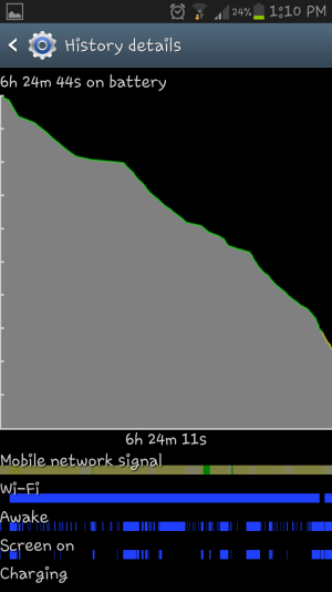

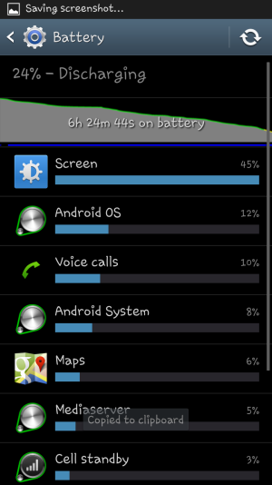

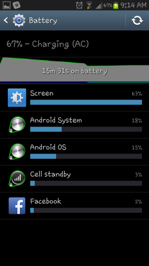

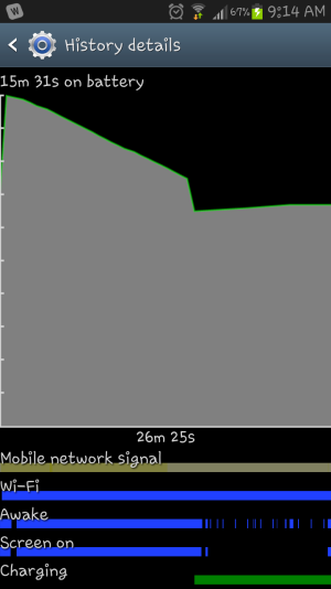

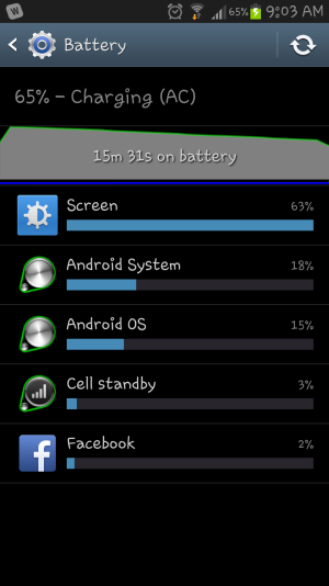

My s3 has recently started draining really fast. I understand I'm using it so it will drain but normally lasts 8-10 hrs on Friday it died by noon. Today it is at 21% and it is only 1pm (this is shown in the last three screen shots) . Used to be good till 5pm. It also said it was fully charged Saturday morning and I unplugged it and looked at Facebook for 15 minutes and it went down 25% then when I plugged it in it went down another 10%(this is shown in the first 3 screan shots)...
Will add to rthis if it keeps happening. Should I take it intp the store?
I keep my data off and keep power-saving mode turned on and normally my screen is set to auto. Turned my screen to almost as low as it can today. Have not downloaded anything new lately.
There's quite a variety of screenshots representing different timelines. I'd suggest sticking to one scenario that starts with the battery fully charged and runs long enough to see the battery around 20%.
Please also include a screenshot showing the Screen on detail.
With that said, you did have one series that showed about 6 1/2 hours of usage, ending around 25%. That does seem to be a bit short, but without the screen on time it's hard to tell. Also need to know what your screen brightness is set at.

The first 3 are from the day where lost 25% in 15 min after unplugging it. And the last ones are from the first scenario I described in my original comment. I normally have my screen set to auto. Switched it today to just over minimum. Will post more today if same thing happens
I find that the battery life is usually very good, but every few weeks, there's suddenly a day or two of very rapid drain like you're experiencing. Android system, Android OS are often implicated, but I can't tell exactly what's happening. Maps are usually mixed in there as well. It seems that Android/Google are doing some kind of background updating or maintenance.
Other than the Screen adjustments already mentioned, I have found it helpful to long press the home key, look at the RAM usuage and clear the memory a couple of times a day. It also seems helpful to uninstall all the updates to Google Maps, then reinstall the latest version of the app. Otherwise I've not found it really matters what else I do - the activity seems to die down and return my battery life to normal in a day or two.
