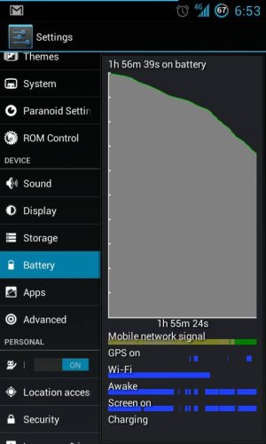

Also just realised, on battery info in settings, it says '22 hours 12 on battery'
I just took it off charge an hour ago which took it from 15% to 100%. (currently 48%)
Do we think the battery might be dying?
Look at the battery graph if the lines awake and screen on don't match almost perfectly some things running in the background. This is the most common and most missed cause of battery drain.
Sent from my refrigerator
Your phone didn't register the phone as being charged to 100%. If it thought it hit 100% the graph would reset and only show discharge from 100%.
Yep you're right, awake is pretty much full and the screen on is just dots here and there.
The graph shows it going up and down rather than resetting. Shows like this for about the last four charges.
