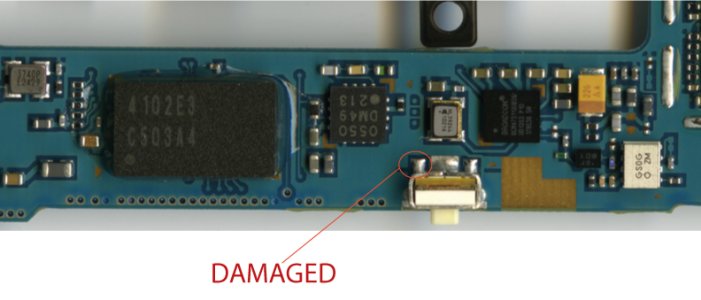

So i carried it to a tech and he pointed out the switch may be good but the part where it solders onto the board is damaged/missing, he told me if i got the schematics for it he may be able to jumper it, anybody know where i could get the schematics?

i have same problem. i am also searching for jumping connections. same point missing from board, plz contact me noumankwl at yahoo .com 07915176201 uk
