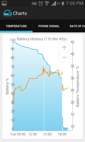

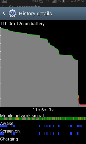

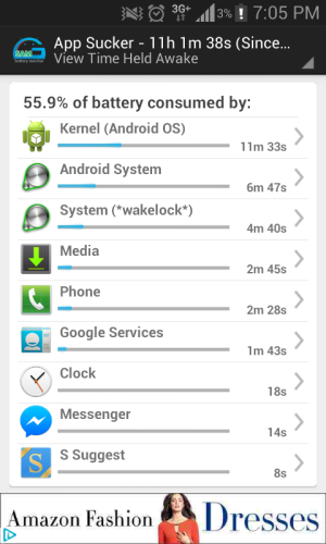

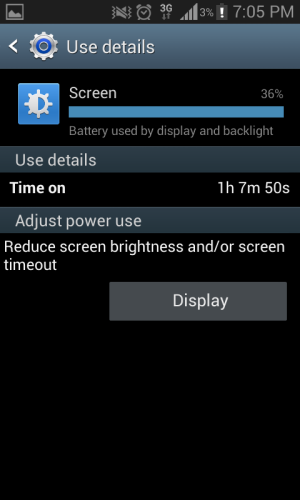

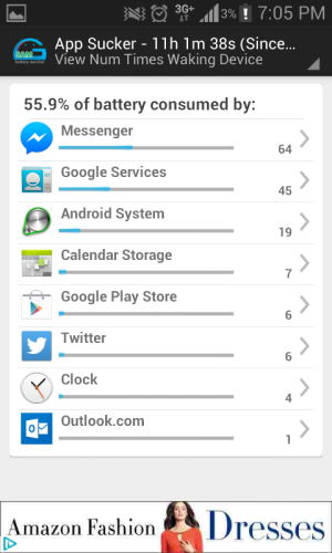

Well, sadly, it looks like I spoke too soon. Here's some screenshots of what happened today:
There's gradual power loss and temperature rise throughout the day, tailing off when not in use but still consistently decreasing/rising, however its still pretty positive after 7 hours until around 1 in the afternoon. About that time, I used it for 5mins to browse and visibly saw it decrease by 3% just in that short period (that first sharp dip). Once the battery started tumbling around 2:30, I manually reset the device, but that did not stem the tide - during the period after this, the device is in infrequent use whilst I check the GSam app and switch off various processes (not that there were many running at all). It inexplicably drops from 70-65% at the same time as the temperature spikes, then there's that huge drop off when the device cut out. I've no idea what happened there, except to say that at the time I was syncing contacts through google (After accidentally deleting them - whoops!), the phone ran down some 10% whilst I was doing this in a matter of minutes, and then switched itself off. I couldn't restart the device for a good 15 mins after that.
The drop from ~60% down to about 10% almost instantaneously looks very much like a battery that is shot. That would be my focus.
