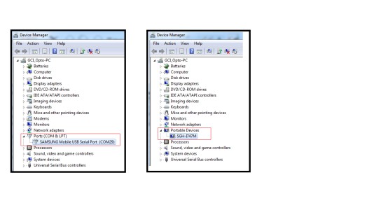

Hi,
I have three Galaxy S3 phones, two SGH-I747M (Android 4.0.4) and one SGH-I747(4.1.1).
When connected to my PC (Windows7), only one out of the SGH-I747M shows up under Device Manger's "Ports (COM & LPT)" while the other two show up under Device Manager's "Portable devices" as can be seen from bellow snapshot:
I need for all the phones to show up under Device Manger's "Ports (COM & LPT)".

Thanks Scott for your reply, I have a software that is used for RF drive testing (Tems), and in order for it communicate with these devices they have to first appear in the Device Manger under "Ports (COM & LPT)" hardware type, otherwise the software will not see them. As for Kies, I think it has no connection to the issue because I was seeing the issue prior to installing Kies and I have only installed Kies thinking that it will resolve my issue when it updates the drivers but that didn't happen and the issue is still there.
