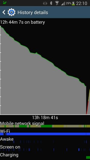

Thanks for the replies so far. Attached is screenshot of my battery issue from last night

Thanks for the inputs. Took my phone to a Samsung service center and ... guess what ... the battery is swollen. Getting a free replacement. Hopefully live can return back to normal then. (-:
