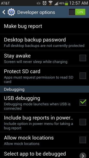

Maybe stay awake is on?
Settings > Developer options
The new firmware disables it. Found you have to go to the "ABOUT" settings and touch the Build Number a number of times, it keeps telling you how many more taps to get to developers mode.
I can't find the developer options in the settings
If you can't find it, that means you don't have it active, so you can't have stay awake on. For the record if you DO want to activate Developer mode, go into SETTINGS > MORE > ABOUT DEVICE
once there, scroll down to BUILD and tap it like 7 times, that will activate Developer Options from the more menu, it will be right above ABOUT DEVICE.
