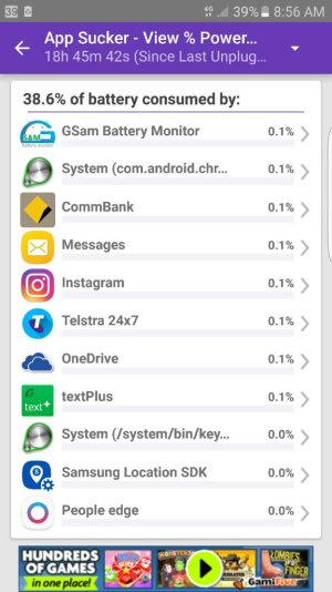

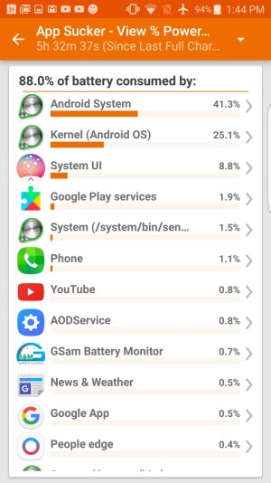

I just got the S7 Edge and am losing more than 1% per hour in standby, while in doze. I am using greenify, but nothing else. I have tried with bloatware both disabled and enabled, and have tried both with always on screen toggled on and off. Help?Screenshot_20160531-134409.jpgScreenshot_20160531-134415.jpg

OP; Turn off things you don't need, start with the Gsam battery monitor, Bluetooth and Wi-Fi if your not using them and any other apps that don't need to be running while your phones asleep.

I get about 1% drop in every 3 hours or so on WIFI and every 5 hours or so if everything is off. But when LTE is ON without wifi, 1% is consumed for every 45-1.5 hours (it depends on signal strength). From your chart it seems your phone is held awake for 30 mins something is producing a lot of wake locks. Check from the wakelock detector. The following are settings that i have.
1% per hour isn't that bad while resting.
Gsam takes up battery?
Yes, apps that check battery constantly take up battery.
6% used in 5.36 or so hours is pretty good I think. 88% shows being used by apps. Screen, Android and unused apps are what eats up batteries.
