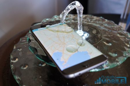

S7 Edge + Water = Damaged Speaker. wait, what? noooooooooo

1. Running it under a faucet is a bad idea. The reason it's rated for 5ft for up to 30 minutes is because that's how much pressure it can withstand. A facuet is concentrating the water pressure and that could surpass what the phone is rated for.
2. It's normal for the speaker to sound wonky for a few hours until the membrane dries. It has water on it so it vibrates differently. That's what you're hearing. Happened all the time with my S5.

So I had to show off my new S7 Edge to my kids and went to the sink and ran it under water. OMG Dad ...
About an hour later I noticed the notifications sounded weird but didn't really think anything of it, thought they were just different or something. Then I was trying to watch a video and I could barely hear the sound and it was scratchy and awful, like an old, 1940's horrible recording. I tried a bunch of other sources and all sounded the same, rebooted, nothing. I begin to cry and thought, did I really just break my 6 hour old phone?
So I shut it off and put it in rice and this morning it is working fine, thank goodness! Not sure if the rice did anything or it just need to dry or what, but I gave my phone a little kiss and said sorry. :D

It's likely just the water in the speakers muffling the sound.
I have a Gear S watch that I wash occasionally with soap and water. The notification sounds are always muffled until the water dries out from the ports.
LOL @ the replies in this thread. The S7 edge is rated IP68, meaning you can keep it in 1 meter of water for a half an hour. Dunking it in water for a demonstration isn't a big deal for this phone.
That's true. It's also true that when the speaker membrane gets wet, it will sound weird until it dries out. That's not a failure, it what happens when its wet. And not charging when there's moisture in the charging port is a design feature to protect you from shorting out your phone, not a flaw.

IP68 means that the device is rated for complete protection against dust (it is dustproof) and is able to be immersed in water beyond 1m (in the S7's case, it means it will be fine in water up to 5m deep, or about 16-feet of water). However, note that I said "immersed". If you look at a phone like the XPERIA Z5, it's also rated at IP65 alongside the IP68 rating. That means that it is not only rated as dustproof and water-immersion resistant. It is also resistant against water jets of a certain pressure, like a faucet. The S7 isn't rated for water jets, so placing it under a faucet isn't a good idea.
Also note that Samsung keeps mentioning "water-resistant" several times. That's different from "waterproof".
In short, it's more for accidental spills. It might be fun to show off to your friends in the washroom sink, but please don't go overboard unless you really know what you're doing. That said, it's fun to take to the pool for a second of immersion when you want those cool underwater photos. Just don't put it under a faucet.
