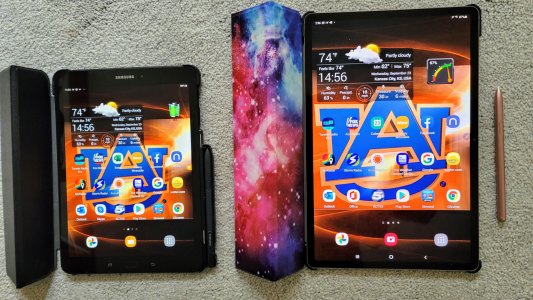

Refer to the photo attached for size comparison between the Tab S7+ and my Tab S3 (9.7 in). Despite significant size difference, weight feels about the same.
I see your problem. That homescreen background is more than likely the problem. . Congrats on the new tablet and thankfully you figured out the cover problem.
