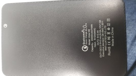

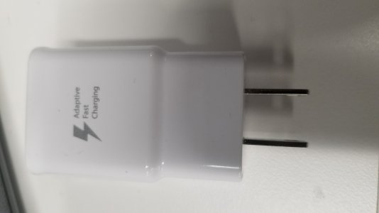

The charger (or power bank/pack) should say Fast Charging or Quick charging. See attached pictures for example (one is a Samsung fast charging adapter, the other is a Kmashi quick charging battery pack). Also, make sure your phone is set to fast charging in the Settings.
Quick charge, or QC is a specific standard by Qualcomm and employs a variable voltage regulator to increase power to the device.
