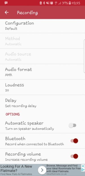

Solution is here....Toggle it off for that annoying speaker during calls.
What in the hell is all that crap?
