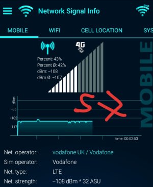

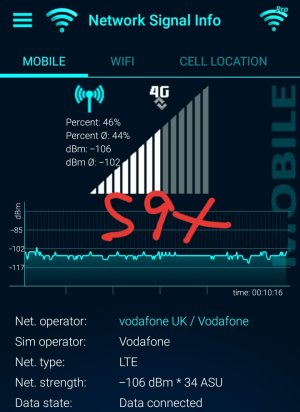

I've had my S9+ a few days now and the phone reception is noticeably worse than my previous S7.
I took my SIM from my S7 and put it into the S9+
Immediately the very first call I took the call dropped after a few minutes. This has continued ever since.
I have weak phone reception where I am but my S7 managed ok 90% of the time on 2 bars. The S9 shows less than this. The only way I can have any phone call of more than a couple of minutes is to change to 3G and even then it sometimes drops.
For a new phone this is very disappointing.
Has anyone else experienced this?
Any suggestions?
I'm considering sending it back as faulty.
