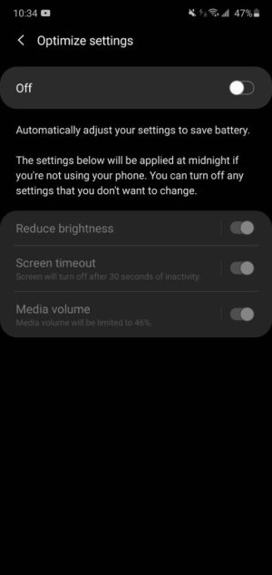

Check in device care app if optimized settings are toggled on ?, make sure no dnd on?, using any medium/adaptive power save modes ?Screenshot_20200714-223610_Device%20care.jpegScreenshot_20200714-223439_Device%20care.jpeg
Hi, the device care/power mode is set for Optimized.. Where is the other setting accessed? If I touch the Optimized, it doesn't show any further screens..
S9 might be different then my Note 10 but turn it off optimized. For the other screen pull your notifications panel down and long press power mode
I've turned it into power mode i.e. optimize off.. Yes I have tried different ring tones in the past with no change.. Optus is one of the telco's here in Australia.. I've googled this problem a lot and haven't found anyone with a similar issue. The only thing I haven't done is a complete factory reset and start from scratch. I've done a soft reset. The ring volume is on the highest setting.
