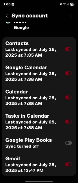

I went in "manage accounts" on the Gmail app. Toggled on and off auto sync data, and then opened the specific email and toggled sync email.
