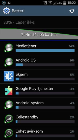

Here is my problem.... Anyone?:'( This is ofc after the kitkat upgrade.
Battery drained halv day without use.
Edit: Found ut that it was Skype that drained my battery WAY faster then normal. Unintalled it and now the phone battery works like a charm.
