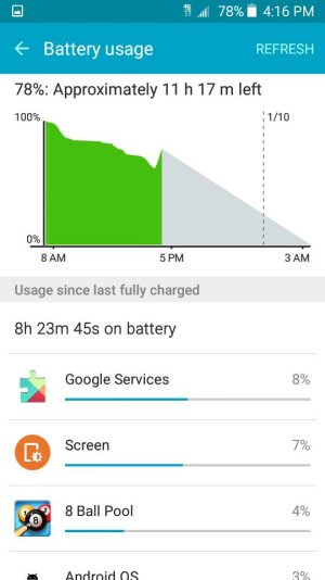

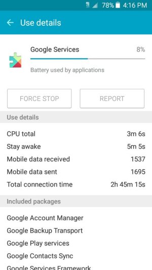

Guys why does Google services waste so much of my battery I'm trying to know is that normal? ?? What am I doing wrong why is Google services wasting my battery that didn't happen last time
Chart
