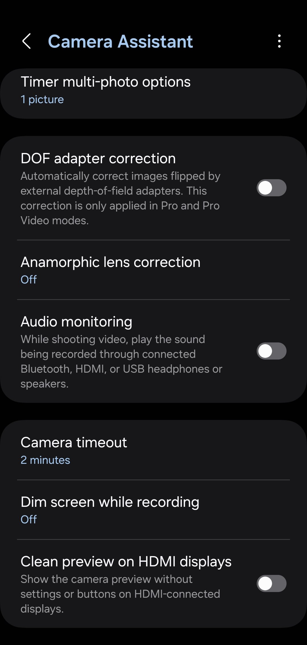

Try camera assistant in Samsung Good lock module u can set to 10 minutes or try something like a Tasker in play store
