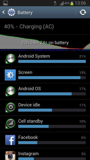

I also face this problem. My battery drains very fast. I have tried to find out which apps use the most battery but found nothing. I just bought my phone for only 2 months.
