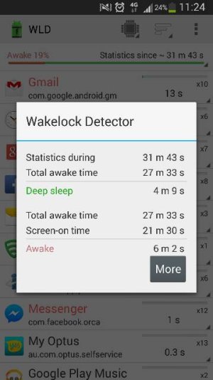

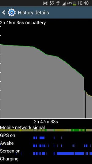

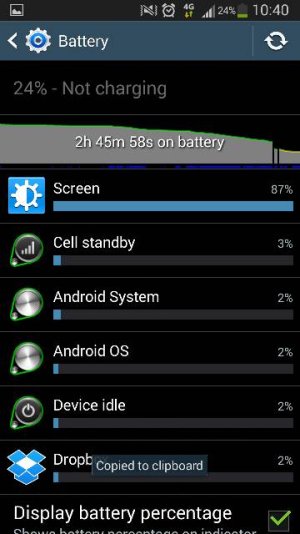

Most days I get around 7-8hrs of battery life and that is with light use. Checking emails occasionally and light browsing now and again. Surely I should get more than that?
This is with a black background, lowered screen brightness, no sync.
I have done a factory reset, installed wakelock detector however the phone is only awake about 20% of the time, and bought a new official battery.
Today I got less than 3 hours when using Google Maps for 30 mins. Now it is almost dead.
Anyone think of anything else it could be? it is really just the screen that uses up the battery so I guess it couldn't be a faulty SanDisk SD card?
Cheers
Chris
I have read other posts and tried various fixes but nothing has worked.

Anytime you experience problems following an OTA it's a good idea to reboot in Recovery mode and clear the system cache, then to perform a Factory Reset (being sure to make a backup first). This will help to minimize strange behavior.
If you'd really like help analyzing battery life it's a good idea to post the three screenshots from the Battery view (main page; History details; Screen on).
