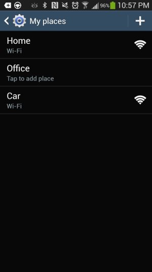

Did you review the solution I posted above? Lots of people inadvertantly add their Wifi to "My Places" for Car. In doing so, you are telling your phone that each time you connect to your wifi, your are in your car and hence enable drive mode.
Go to Settings | More |Location Services | My Places | Car and make sure you did NOT select WiFi

Thanks so very much. I just did that . After I turned wife off for car so far driving has not started yet but I wonder , will I be able to get wifi connection while I was in my car when it is turned off for car? thanks again . saroj I hope samsung will train their staff both sell and service to resolve issues. I felt like a fool when I check with samsung center at the mall , they all said that it is unheard of to them. told me to go to service guy who said he will have to redownload my phone again which I will lose all info.
