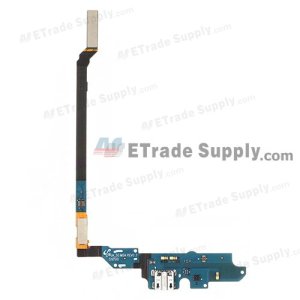

>Replaced the USB port: WORKED!!
I just bought mine in less than three months (From Kimstore, online shop in Phils) when the problem showed up.
I really need to connect Galaxy S4 to my computer so i want this problem fixed asap.
I have no time to have it replaced or checked with warranty plus its a hassle to go to the Samsung service centers here in the Philippines.
So I decided to change it myself with a help of a youtube video on how to open S4
>>Samsung Galaxy S4 Screen and Charging Port fix. Complete tear down. - YouTube
Anyway after changing the port it was immediately fixed! the charging sign can be seen when i charged it and I can now connect it to my laptop haha.

Try asking where you can buy "S4 USB port" or you can show this pic. When you finally find a stall,
you can also purchase there the prying set

Kevin, can you let me know how to select the correct micro usb board for my samsung S4? I see that there are many variations that look alike. Could it be that there has been superseded part numbers? I have seen that there are i337 and i545 part numbers, both for S4 phones. Is the i545 a newer version with different options? How to determine which one will work?
